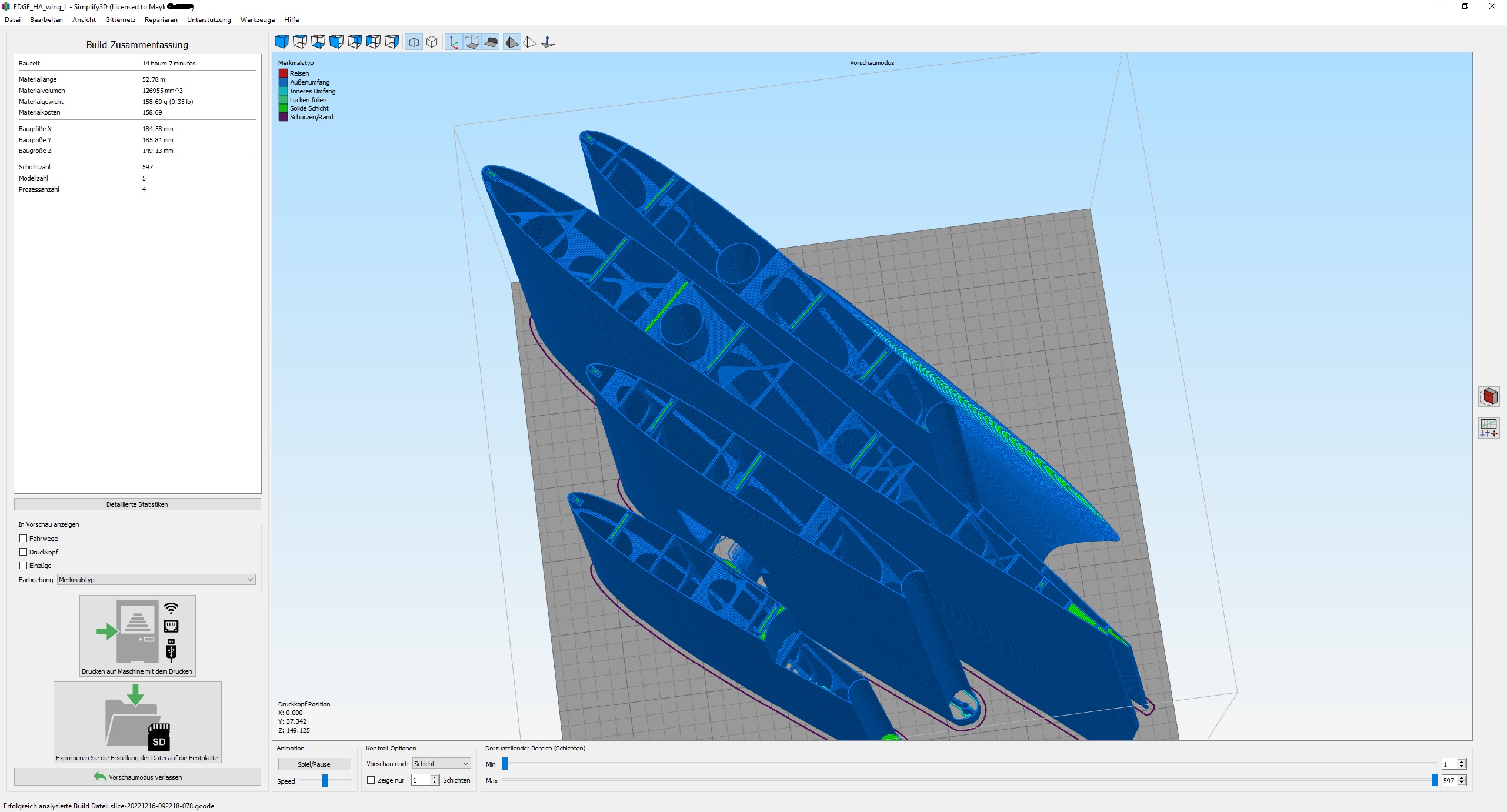

Re: Simplify3D V5 no longer useable for RC airplane prints
@ InspGadgt What Model is this? I have a lot 3dLabprint Models. Tried the B25 and it´s working, If you tell me what part makes the problems I can test it here.
Regards#

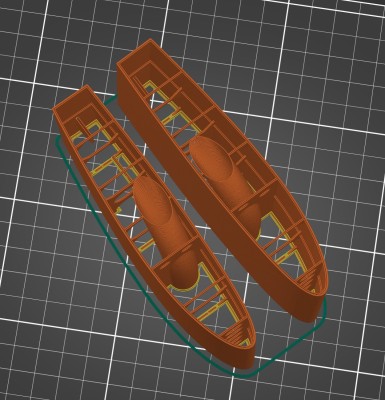

wirlybird wrote: Thu Dec 15, 2022 11:54 pm What is the sliced part supposed to look like? I did a check on the file and it has many errors and is 23 shells.
This is what it looks like sliced in PrusaSlicer.
