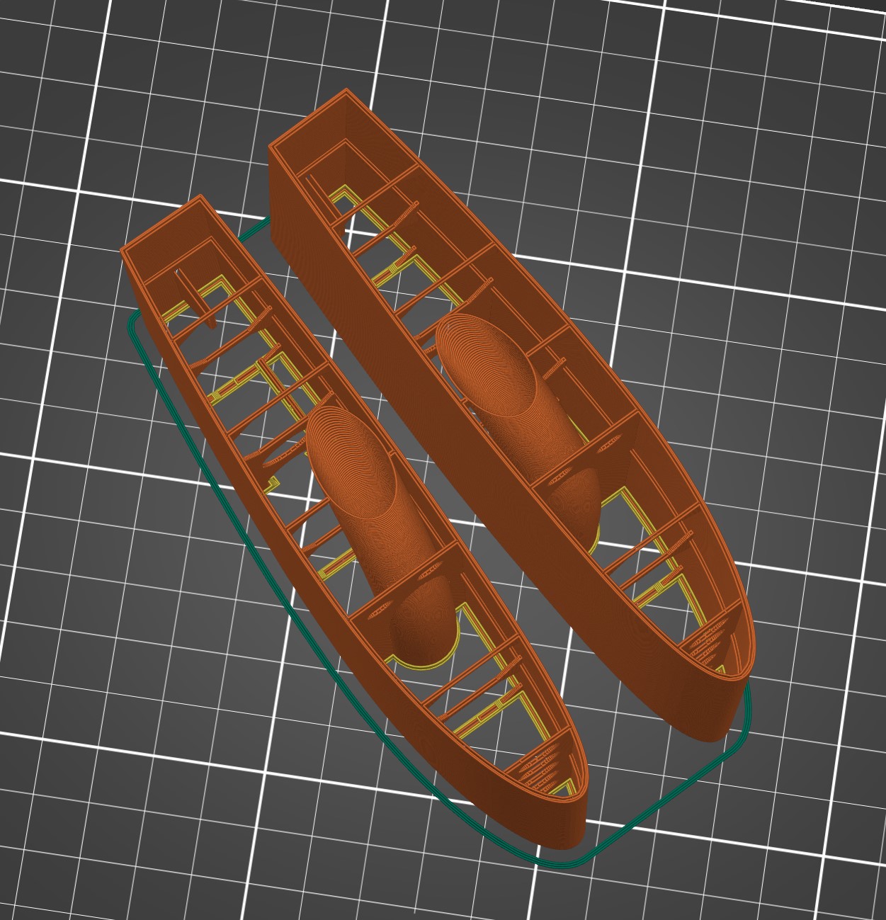

Here is the stl for the part I've been using for testing.

What is the sliced part supposed to look like? I did a check on the file and it has many errors and is 23 shells.

wirlybird wrote: ↑Thu Dec 15, 2022 11:54 pm What is the sliced part supposed to look like? I did a check on the file and it has many errors and is 23 shells.
This is what it looks like sliced in PrusaSlicer.

wirlybird wrote: ↑Fri Dec 16, 2022 12:06 am I've tried slicing in three slicers and get the same result in each.
Is there some specific settings they recommend?
PrusaSlicer and Cura both can slice it properly with some settings adjustments.
https://3dlabprint.com/faq/prusaslicer/
https://3dlabprint.com/faq/cura/
